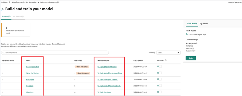

when publishing the topic with nlu model iam getting error message like latest version is already published.
without nlu model the topic is getting published . and utterances also getting trained successfully in designer as well as nlu workbench . in workbench publish view phase publish button got greyed out.
can anyone of you please help with issue and also iam attaching screenshot for your reference what iam facing.

1) Check all active intents are mapped to VA flow. If for any of the intent, mapped objects (VA flow) is empty then make that intent inactive.

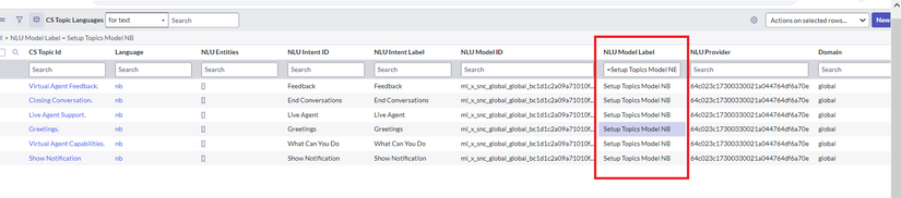

2) When you publish the model, it queries "sys_cs_topic_language" language. Go to this table list view and filter the records for your NLU mode. This record count should match up with your active intent count.
sys_cs_topic_language.LIST
Follow above steps and the try to publish model.

Hey @SANDEEP28 what you had mentioned all the steps are I followed what can we do if NLU model label count and active intent count would be different and how to manage these.
and in the designer iam able to publish the topic but in the nlu workbench the publish button got greyed out.
can you please help on this.
