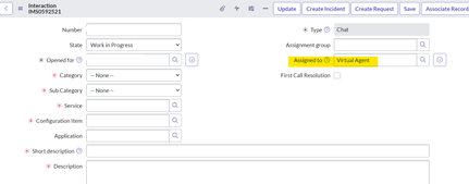

How Virtual agent interaction record is auto-populating "assigned_to" field with "Virtual agent" user?
Currently we are using virtual agent for both IT and HR portals. We need to identify/Differentiate interaction records based on portals.
How can we achieve this?
Thank you in advance.

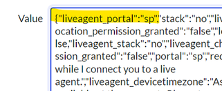

To identity portal from the Interaction records
Navigate to interaction.LIST
Check the context record field
Open the context record. It will take you to the interaction_json_blob table record
From the value, you can get the portal name
