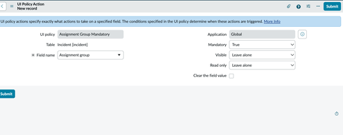

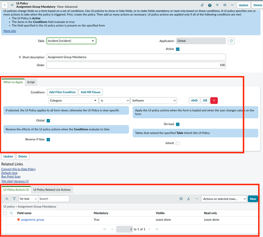

Hi folks. Quick question on mandatory fields in Incidents. Is it possible to use conditional logic to make a field mandatory on Incidents? For instance, if the category is application, then make the service a mandatory field.
Todd Goodhew
Yes.  Use UI Policies for this.

If you want to make a field mandatory based on a condition (for example, when Category = Application, make Service mandatory), there are two common approaches:
UI Policy (Best for simple/static configuration)
If the requirement is simple and statically driven, UI Policies are the best and recommended option.
UI Policies allow you to:
  • Define conditions (like Category = Application)
  • Make fields mandatory, visible, or read-only
  • Avoid scripting and keep the configuration clean and maintainable
This works well for most standard requirements and is easier to support long term.
onChange Client Script (For dynamic logic)
If you need more dynamic or complex behavior, an onChange Client Script can be used. This is useful when:
  • Multiple conditions are involved
  • Logic cannot be achieved using UI Policies alone
  • Real-time calculations or advanced checks are required
Recommendation
For this specific use case (Category = Application → Service mandatory), a UI Policy is the best approach.
Use an onChange Client Script only when UI Policies are not sufficient.
The screenshots already shared by other community members correctly demonstrate this setup.
