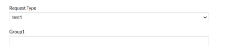

 Here are the screenshots from my PDI:
Catalog Client script:
Updated script:
        return;
    var type = g_form.getValue('request_type');
    if (type == 'create') {
        g_form.setVisible('group1', false);//group1 is the variable name in variable set
		//similarly add other variables
    } else {
        g_form.setVisible('group1', true); //To show back the variable when type is not 'create'
Variable in variable set:
Result:
when request type is not create
when request type is create
Note: type == 'create', here 'create' is the value assign to the choice Create
