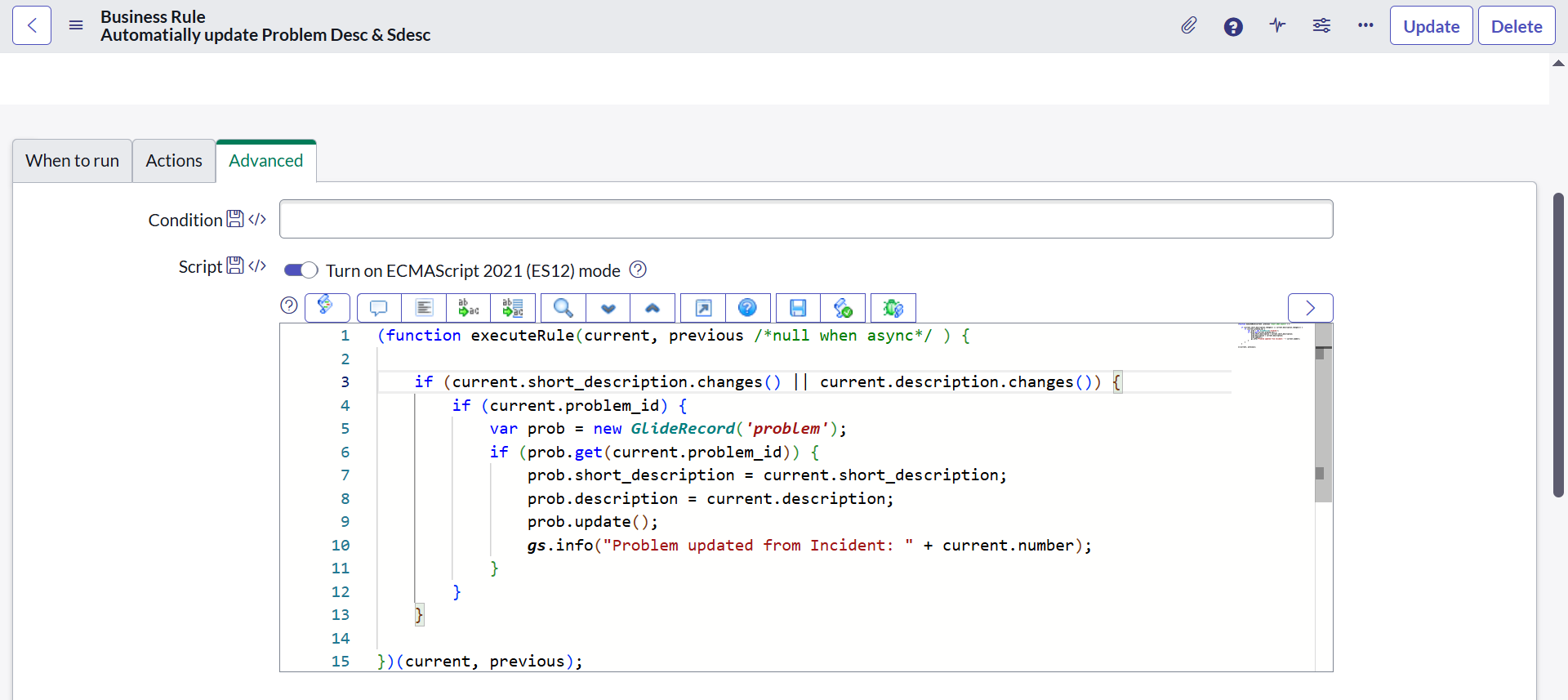

Hi @P1234
Hope you are good.
Below is the solution for your query, basically you should use After Update Business rule.
PFA the screenshots, this particular use case is perfectly working on my PDI, hope this helps! If this helps you to resolve your query, please mark it correct and accept the solution, Thanks 🙂
Below is the Code:
    if (current.short_description.changes() || current.description.changes()) {
        if (current.problem_id) {
            var prob = new GlideRecord('problem');
            if (prob.get(current.problem_id)) {
                prob.short_description = current.short_description;
                prob.description = current.description;
                prob.update();
                gs.info("Problem updated from Incident: " + current.number);
})(current, previous);
If you found my response helpful, please give it a thumbs-up and designate it as solution accepted to support fellow developers and admins.
Rathan K

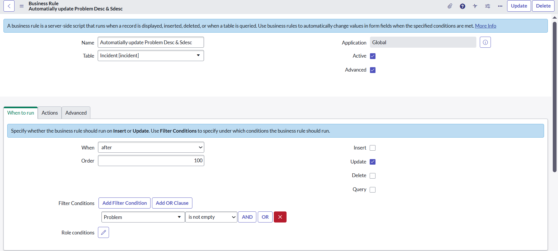

Ankur Bawiskar
@P1234
business rule should be after update on incident
Condition: Description Changes AND Problem Field [IS NOT EMPTY]
Script is correct.
Hi Ankur,
Sorry i set the condition is same like Description : Changes , Problem : Is not empty.
But not working
@P1234
did you debug business rule and see if that triggered?
Hi @P1234
Hope you are good.
Below is the Code:
                prob.update();
Rathan K
