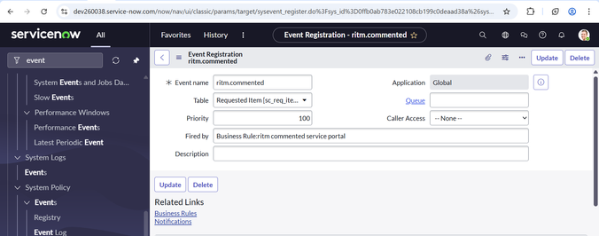

1. create event
filter navigator->system policy->event->registry-> new

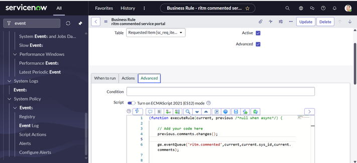

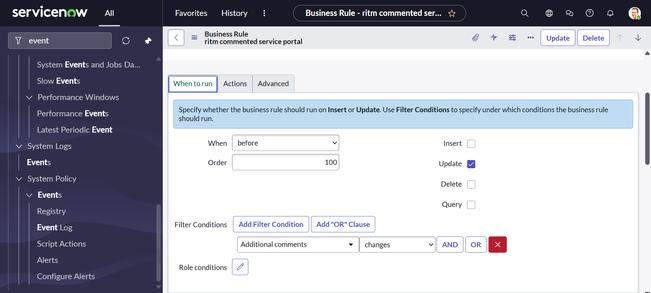

2,Business rule:
system definition->business rule->new

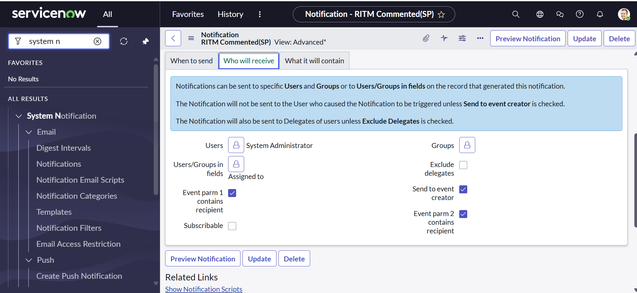

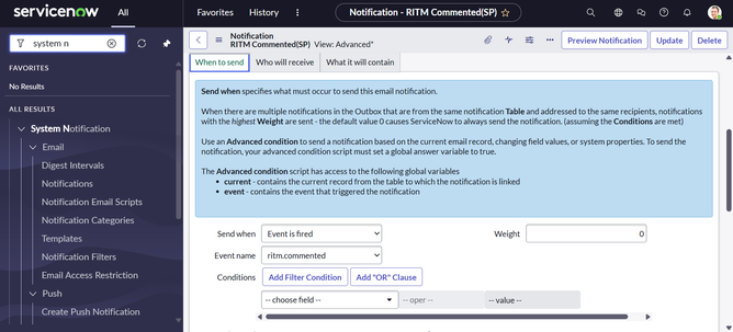

3. notification :
system notification->notifications

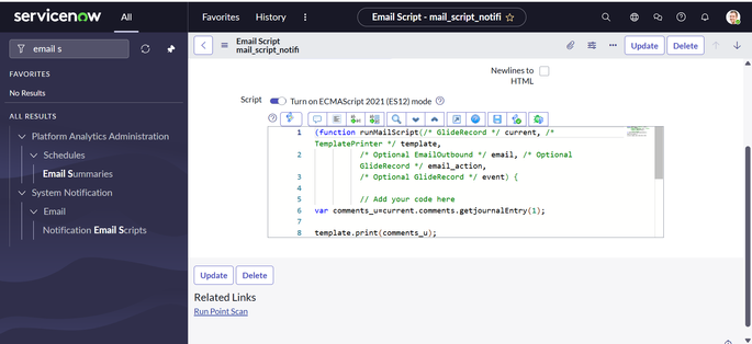

email script :
system notification->notification email script
