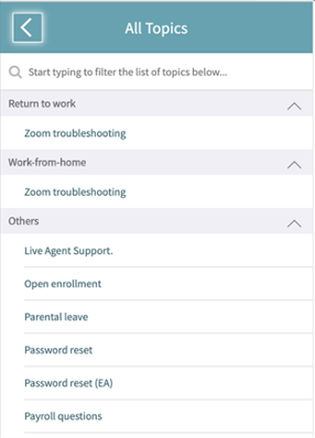

Custom Categories will get you fairly close to what you want with minimal effort and maximum sustainability: Create or modify custom categories | ServiceNow Docs
Note that by default the categories are expanded unfortunately (can't be changed - yet at least), so if you only have two categories, the user can easily click the first HRSD category to minimize it, then easily see all the ITSM topics. Not ideal, but again, it's super simple and fully supported ootb. (p.s. don't forgot to go back to all your topics and add them to these new categories!)
