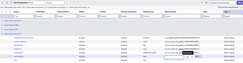

I found the case and the issue was fixed for April. The root cause to this issue is documented in KB0861056Clone does not preserve ML Solutions when setting property glide.platform_ml.clone_artifacts to true (Note: You need to be logged into ServiceNow Support to see this KB article).
I suspect it is missing the artifacts for the Vocabulary Source Lists associated to the NLU Model. You can either export the missing attachments on the [ml_model_artifact] records by exporting these records from the source instance to the target instance. Alternatively, you can retrain the NLU Model after removing the "solution_name" value from the [sys_nlu_vocabulary] table, where Type='Static Lookup', as follows -
When you have removed this value, retrain the NLU Model that is linked to the Vocabulary Source List, and it will regenerate the missing model artifacts in table [ml_model_artifact] with the new solution name. For Vocabulary Source Tables, you can manually sync them in the Vocabulary Sources module at any time, although they should be re-synced every 7 days.
Hope this helps.
