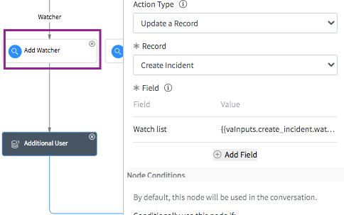

I have a field called "Watcher" from create a incident topic.
So, I have added "Reference Choice" as input and I can select only one user at a time.
But I want to selete multiple user's from the list and update in the incident record.
I have followed the below method to select the multiple user's but it adds the one user as watcher from incident record.
Like, it takes only last selected users from the "Reference Choice"
There is one simple minor issue with your design, you have to use the input from the Additional Watchers below the Watcher decision.
There are a couple of components with similar names which could have caused the confusion.
I have modified the topic name to "Add Watcher" for that component to understanding it better,

what you have done is correct but below the reference choice, you have to add a record action component to add the users to the incident table
Like below, the component is "record action"
and the field to update is watchlist, I used the below logic to update it.,
first grab the existing watch list from the inc selected and then add the new user to it. Both are separated by a comma.
I tried in my PDI and it works.
I tried this but didn't work.. Can you tell me where i'm doing wrong?
Record action:
Where you're updating the Watch List field, you're appending the "Additional User" input to the field where you should be appending the "Additional Watcher" input.
I don't have enough information to see fully why your Group List is null though. I can see that you don't update the Incident record after getting "Additional Group Watcher", so that input is currently not being used, but that doesn't explain why the field on the Incident is nullnull. I'd need to see the fields you're setting in "Create Incident" to help explain that.
