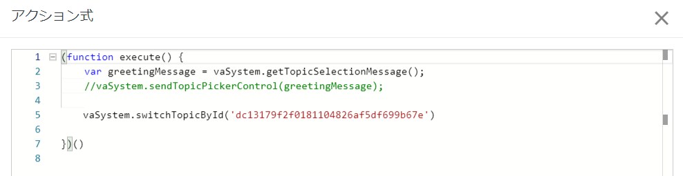

05-18-2022 04:33 AM
Thank you very much. It will be very helpful.
Currently, I want to move only one topic, so I want to hide the "Show me everything" button.
Is the method of hiding the button correct by commenting out the second line of Script?
1.Setup Topic > Greeting
2.Script
