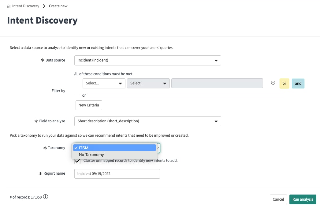

The Intent Discovery report is based on Taxonomy and ITSM is the only taxonomy supported in San Diego, but more will be added in Tokyo, hence you will only see Topic recommendations based on this scope only. You can change it to "No taxonomy" for generic Topic recommendations -

I am going to try the "no taxonomy" see what it does.  It is just annoying that the findings are on ITSM Intents when I have topics and intents that catch the utterances already. I notice these analysis are used in the Topic recommendations as well.
Thank you for the detailed response! It gives me a way to get what I want out of these analysis's!
