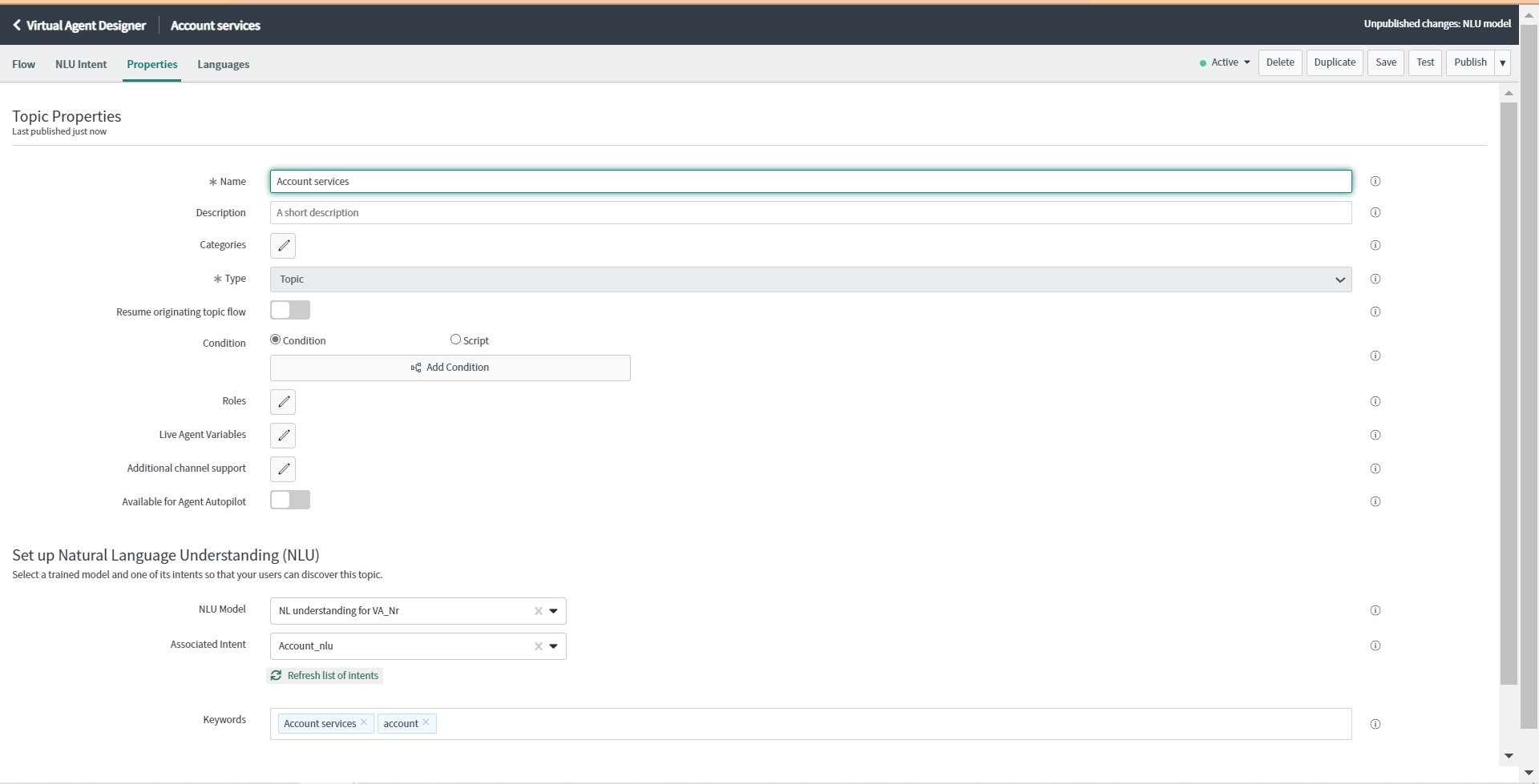

If NLU is enabled for Virtual Agent, did you link the VA Topic to your new NLU Model/Intent. When you open the VA Topic, does it show your utterances in the NLU Intent tab? Can you provide a screenshot of the Properties tab for this VA Topic?

Hi Brian,
Thanks for your reply. NLU for Virtual agent is enabled and is linked to the topic.
Could you please elaborate the second point you mentioned about default chat experience also I am attaching the screenshot of properties tab for your reference.
