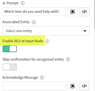

As Lynda said in a different response, you can try to select the option "Enable NLU at Input Node":
Users can enter text to select items or switch topics from this node when this switch is enabled.
I didn't put this option in my initial response because I tested it out and this use case wasn't working for me. Plus, even if it was working, I don't like the idea of enabling NLU at random inputs - it can easily cause unintended consequences (switching topics), especially if your model has a relatively low confidence threshold and/or triggers topics with one word utterances.
I suppose there's a low risk if you're using it for Yes/No inputs ("yes" and "no" certainly should not trigger any intents) or other very simple options ("one" vs "many" seems safe as well), so you can try it out yourself and see if it works for you.
Lynda1
Chris D. suggestion is the best.  if you are instant on this approach, you can turn "Enable NLU at Input Noe"
