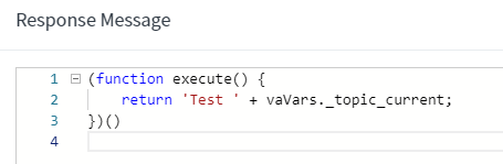

‎07-17-2020 11:19 AM
I was using the virtual agent previewer before
I changed it to try to output as a bot response so I can test it outside the previewer and seem to run into the same issue running the chat from /$sn-va-web-client-app.do
I made it the first message in our greeting topic
If i use the full JSON line you provided I get the bot technical issues message
JSON.parse(vaVars._topic_current).task

‎07-21-2020 06:27 AM
I opened a Hi Support Case, I'm not sure how anyone would find these hidden variables without asking the SN support.
Object.keys(obj) *should* be able to find things like this, but doesn't seem to work in most cases.
From searching around these vaVar variables prefixed with "_" appear to be undocumented.
