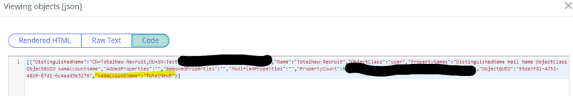

Here is the object that is returned from the Spoke, I want to retrieve the value "TotalNewR" to use in a later step:

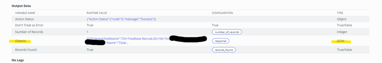

This is the output data from the spoke:

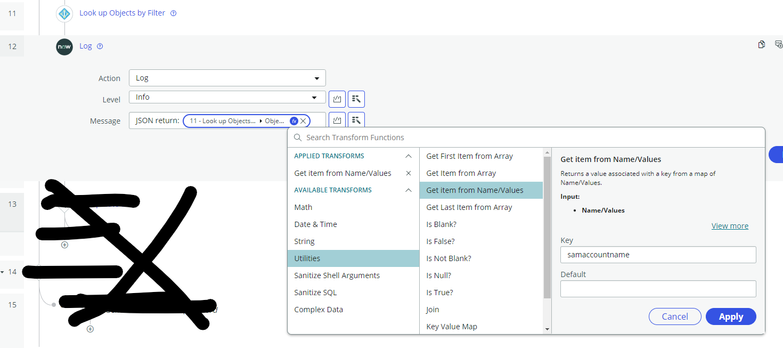

Here's how I configured the function - for now I just want to display it in a log until I get it working.
Is this possible to retrieve the data this way or do I have to write a custom action to parse the JSON object returned from the spoke?

Hi gjz,
please be aware, that you are looking up objectwitch your previous flow step. Hence you are receiving an array containing the object where you want your "Get Item from Name/Values" transformation to work. Consider to first to a "Get Item from Array" transformation first, i assume this will solve your problem.
