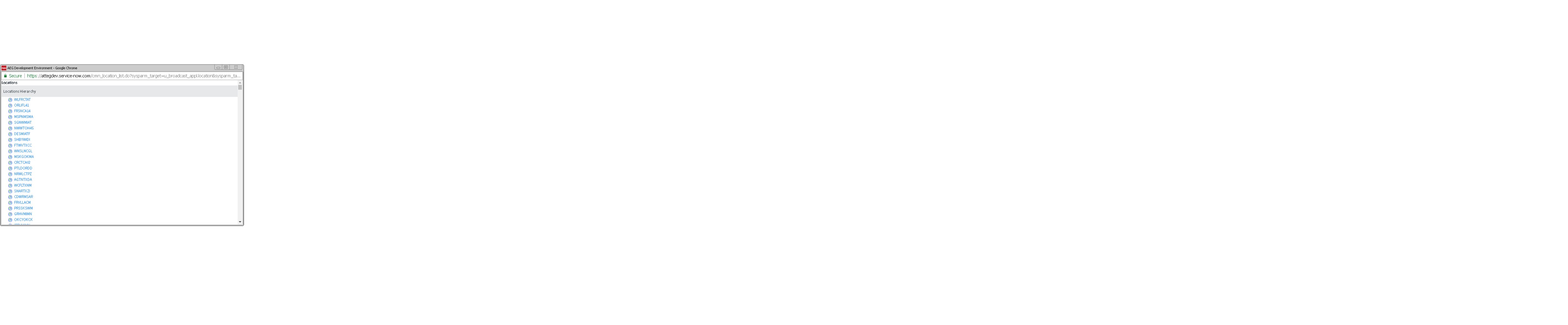

I have a form both with reference fields to Locations and manufacturer; The manufacturer reference search list displays various fields but the Locations only displays a list with one field with a globe icon - "scroll list not searchable". I would like to provide the user with more than one option when searching for a location such as Address, name, city, state. Can anyone point me to the topic where I can find this?

This is all I get. I want to change this view and give the user the option to search by address , city, state, etc.
Try the attribute like
ref_auto_completer=AJAXTableCompleter,ref_ac_columns=email,ref_ac_columns_search=true

Check if you have the Tree Pricker attribute enabled?
If yes, for your table, you should create a dictionary override record and click on override attribute. Then it should give you a list view and from list view you can add or remove columns you want using list layout
