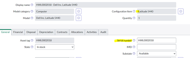

not showing serial number#

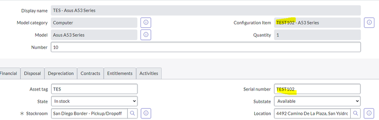

I am hoping to fix it so it will look like this which is in my PDI.

Hi @ND7 ,
Correct me if my understanding are wrong, you want to Amend the serial number in the configuration item filed on asset table and configuration items field is reference of Cmdb table.
If i am not wrong, the OOB behaviour of display CI name will be populated based the CI host/name, You can change the display value of for Configuration item after ammeding the Serial Number with hostname of CI.
