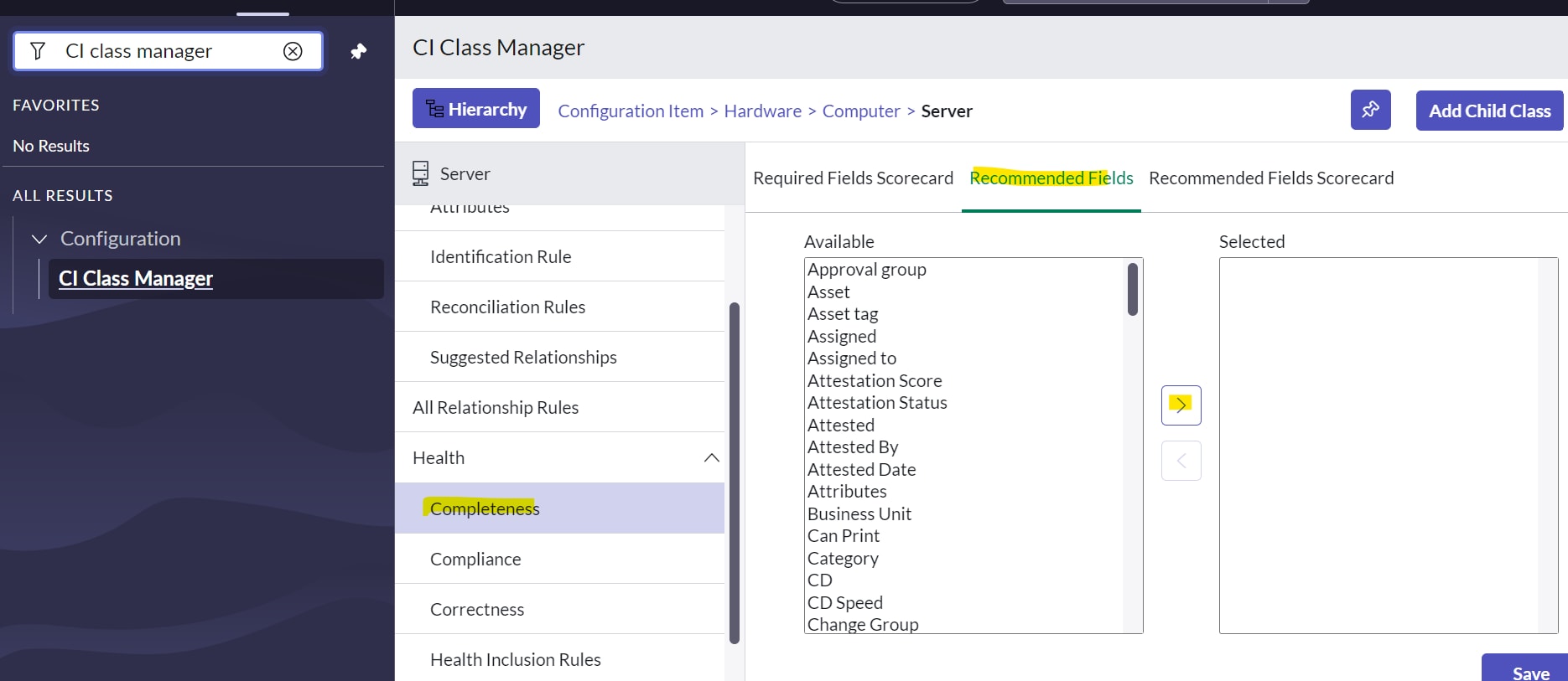

The fields for a particular CI class that are used to store important data attributes can be considered as recommended fields. At the same time, these fields should NOT be marked as mandatory for that CI class (Since those will be considered as the 'required' fields). Examples of some fields that can be considered as recommended fields are Location, Manufacturer, Model ID, Support group etc. i.e. The objective is to consider the fields which might help the operation or support teams in speeding up tasks like root cause analysis of incidents/problems, impact analysis of incidents/changes, issue resolution etc. as recommended fields. The exact list of recommended fields for each CI class should be determined after discussing with configuration manager and respective CI class owners. It would be better to consider a limited number of important fields for each CI class as recommended fields.
Following is the procedure to set recommended fields:
Go to CI class manager, open a CI class and click on 'Completeness' tab under 'Health' menu. Then click on the 'Recommended fields' tab. You can set the list of recommended fields here (screenshot attached for reference).
