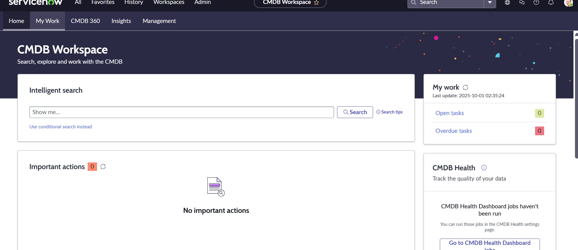

In the CMDB workspace there is MY work , in that i have to edit the Open tasks table name or i have to add new table next to it , please help me how to proceed with it, if found this table sn_cmdb_ws_imp_action_card_config here i can able to edit filter condition only not the table name , where to add new table also can any one help

Hi Bhuvan,
Thanks for your response, in the Home page we have My work container there Open task table name need to change , or i have to create a new Option
@Jeya priya
Logic is same, go to home page and create a variant. Below is for sample from my PDI
Go to Editor and and add the section based on your requirements and configured it. As mentioned earlier, make the new variant as lower order to take precedence. Or disable out of box variant and keep this variant active.
