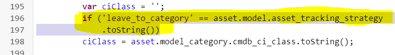

I have written a Ui action as -(new AssetandCI()).createCI(current); current.update(); action.setRedirectURL(current);" to create CI from asset record where CI is empty but this is not working.Any tips?

Check the asset details whether asset is having the serial number or not.
It is one of the main attribute for the CI.
Also there is out of the box BR which will automatically create CI from asset once serial number is assigned to the Asset.

Kindly check and confirm this.
