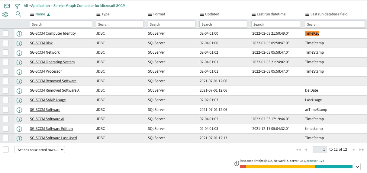

It should be "TimeKey" for "SG-SCCM Computer Identity" source from the query that has this line "WorkstationStatus_DATA.TimeKey as TimeKey".
Here are the other ones.
Hello and thanks so much. It's the SG-SCCM last discovered Update.  I see you have Timestamp whereas after my upgrade the default was blank.  So wanted to understand the logic to this function before deciding what to manually add to "Last run database field.  Is the norm to add timestamp?  What does the do?

To add to what Patrick has suggested and for your 'why' question, SCCM will update the 'TimeKey' field if any of the computer attributes were modified/touched within SCCM. Hence, this is the field we are using to pull incremental computer data (only the changed or newly added) from SCCM as opposed to a full pull every time you run the computer data source.

Is it only Timekey, Timestamp and a/timestamp.  I have failed to find a list anywhere on the options and there explanations.
What do you have for "SG-SCCM Computer Identity"?
