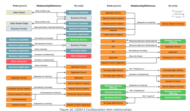

For me, to Depend on something it needs to be fundamental. In the "CSDM 5 Configuration Item Relationships" Diagram, the only relationship between Service Instances (even though they still have the CSDM 4 terminology of Application Instance) is Depends on::Used by. Yet when you look at the relationship from a different form on the SN platform it becomes Contained::Contained By. Which also seems wrong.
In SaaS service terminology, you are consuming the service. But that is not an option. I have not seen the option to use the "Consumes::Consumed by". In fact in all of my CSDM 5 documentation that is not an option.
Is there an updated version of documentation that shows the "Consumes" relationship? Is there a specific form for this? As I can only see "Contained" and "Depends on" as generated CI relationships.
I also do not see your "Business Application as consuming a Service Instance" relationship. I am using the CSDM 5 White Paper:

I went back to the CSDM 5 white paper and I mixed some of the older CSDM relationship terminology into my previous answer.
In CSDM 5, the relationship shown between a Business Application and an Application Service is Uses::Used by, not Consumes::Consumed by.
And between Service Instances the white paper does indeed show Depends on::Used by.
So on that point, what you are seeing in the model is consistent with the current CSDM 5 diagram.
I also understand your point about Google Maps better now. I wouldn't insist on modelling Google Maps as a Business Application in the scenario you described. If you are consuming an external location capability through an API, and you don't manage Google Maps itself as part of your application portfolio, then treating the API/service as part of the Service Delivery model makes more sense. CSDM 5 actually calls APIs out specifically as part of that domain.
Where I still find it a little confusing is exactly the same place you do: semantically, saying that CRM "depends on" the Location Service feels stronger than saying CRM "uses" or "consumes" it.
But from what I can see, Depends on::Used by is the relationship ServiceNow currently prescribes between Service Instances, even if it doesn't always read naturally from a SaaS/API perspective.
