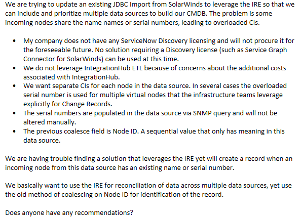

We are trying to update an existing JDBC Import from SolarWinds to leverage the IRE so that we can include and prioritize multiple data sources to build our CMDB. The problem is some incoming nodes share the name names or serial numbers, leading to overloaded CIs.
  • My company does not have any ServiceNow Discovery licensing and will not procure it for the foreseeable future. No solution requiring a Discovery license (such as Service Graph Connector for SolarWinds) can be used at this time.
  • We do not leverage IntegrationHub ETL because of concerns about the additional costs associated with IntegrationHub.
  • We want separate CIs for each node in the data source. In several cases the overloaded serial number is used for multiple virtual nodes that the infrastructure teams leverage explicitly for Change Records.
  • The serial numbers are populated in the data source via SNMP query and will not be altered manually.
  • The previous coalesce field is Node ID. A sequential value that only has meaning in this data source.
We are having trouble finding a solution that leverages the IRE yet will create a record when an incoming node from this data source has an existing name or serial number.
We basically want to use the IRE for reconciliation of data across multiple data sources, yet use the old method of coalescing on Node ID for identification of the record.
Does anyone have any recommendations?
