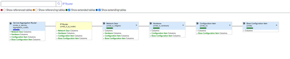

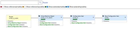

In Vancouver ServiceNow CMDB instance I see 2 tables with router and similarly 2 table for switches.
Please help me understand what the difference between both router tables and switches table is?
Also which one to be used to populate CMDB and which should not be used ?
Routers –
Service Now Table Label (Class)
Service Now Table Name
IP Router
cmdb_ci_ip_router
Router
cmdb_ci_router

Mark Manders
You can check on the schema maps of the tables to see how they are connected.
For the routers for instance:
And how to use them, is all up to what kind of routers you have and how you are using them.
