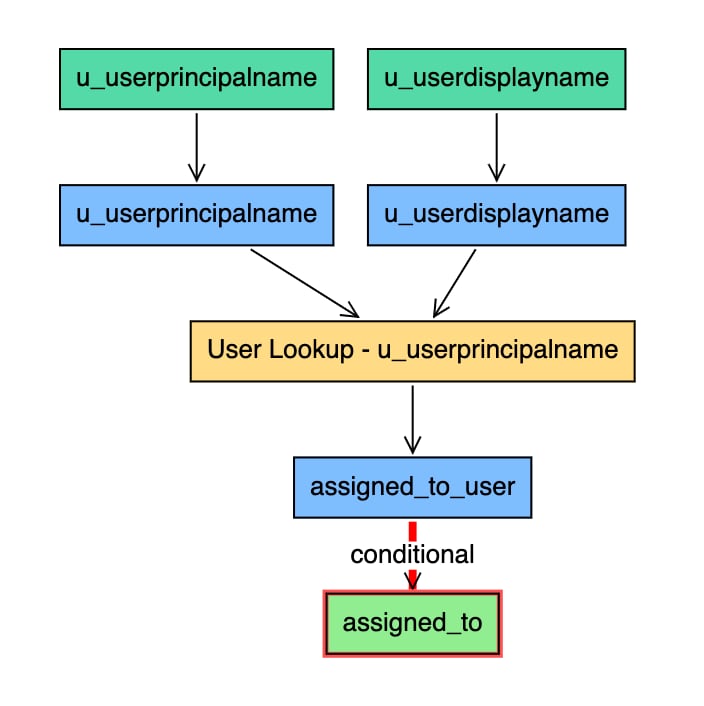

Kieran Anson
The API value that is used by SN to perform a lookup is the userPrincipalName value. The value is dependent on the device type (assigned vs shared) and doesn't correlation 1-2-1 with the Intune UI. For the most part, it can be seen as correlating to the Enrolled User field.
The two field returned from the Intune API are userprincipalname and userdisplayname.  These fields are used to lookup the user in ServiceNow's sys_user table and then take that reference to populate the assigned_to field for the handheld computing device.
Here is a visualization of the assigned to mapping in the Service Graph connector for intune devices:find_real_file.png
The User Lookup - u_userprincipalname operation will do a lookup on the sys_user table.  The logic in this lookup isn't trivial but can be read from the CmdbIntegrationUserLookup script include.  It will essentially do a 3 pass user lookup.  First, by whatever field is defined in the value of the glide.discovery.assigned_user_match_field system property.  Second, by the user_name field.  Third, by the email field.
