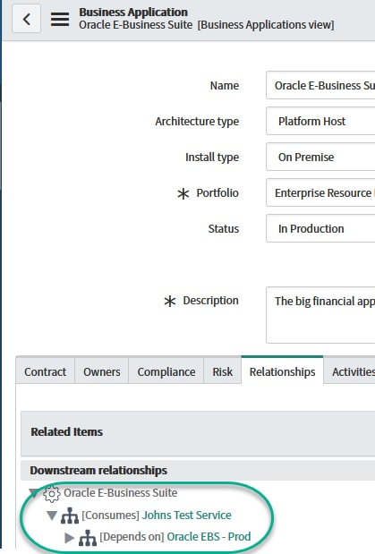

For anyone else who finds this.
How to relate 'empty' or 'logical' app services so they are referenced in Impacted Services

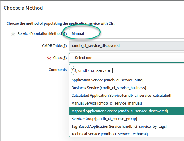

- Create your new application service.
- Link it to a business application.
- Choose manual population method, and filter the class to find the other app service you want to to be dependent on. In my case I am making my empty app service dependent on a Service-Mapped app service which represents the platform host. My new app service is a dummy 'module'
- After it is created, you will see new UI actions. Click Advanced
- Click 'Convert to Dynamic Service'
- Voila - now your new app service has the correct references in 'svc_ci_assoc' and is dependent on the app service you selected. If you perform a change on your main platform host CI, your 'module' will be pulled in as an impacted service.
