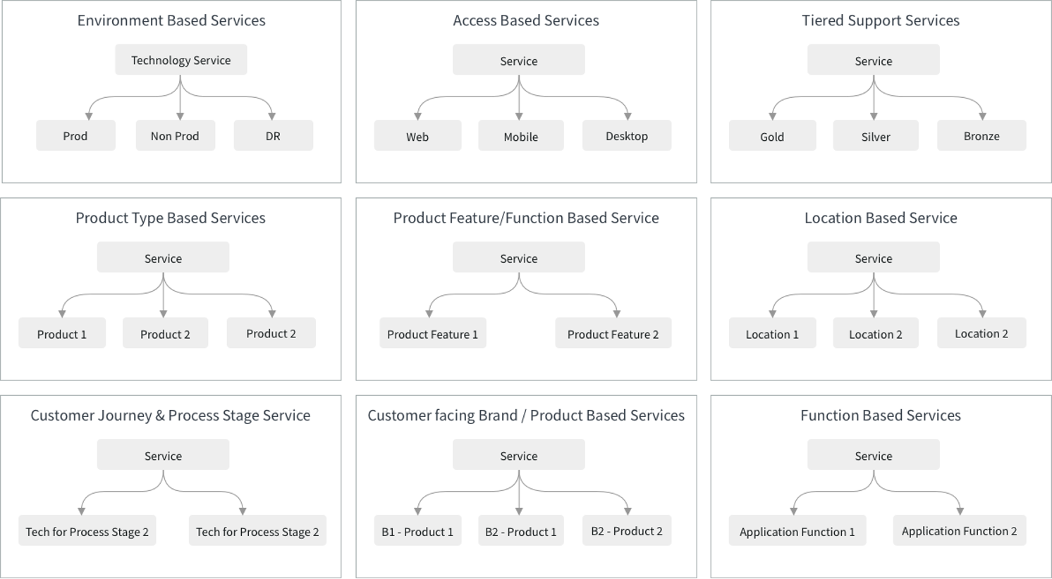

I have a good conceptual understanding that there are various potential criteria that one can use to define Service Offerings -- location-based, product-based, scope-based, etc. But what I struggle with is how to approach the challenge of defining Offerings when there are multiple factors at play. For example, let's say I am defining the following Technical Service:
Service Taxonomy (TBM based): Service Type = Infrastructure Services; Service Category = Network
Technical Service: Virtual Private Network
Now there may be several different offerings here that vary by several factors, which may or may not overlap:
* Desktop vs. Mobile
* Full client vs Thin Web Client
* Cisco vs. Juniper
* High availability vs. Standard
Let's say a region in the US where headquarters are located may provide all of the above to support their remote workforce in a variety of different ways and scenarios. Each of these would be different offerings. But another region, let's say a Sales office in the UK, may choose to define only a single Service Offering, Cisco which they manage locally.
So having said all that, what would be the best method of defining the various flavors of VPN in appropriate Offerings?
Seems there are a lot of things that we could do but I am not sure which would be the most beneficial.
- Define offerings in a flat structure and just overload each offering with all of the attributes that distinguish it from other offerings - use Location, Scope, Service Commitments, relation to the applicable Application Services, and the Name of the Offering itself (which could also be overloaded with some of this information, e.g. US HQ Cisco VPN).
- Possibly consider using Parent/Child Services (CSDM advises against this) or Parent/Child Service Offerings (it isn't clear whether this is allowed)?
- Other approaches I haven't considered?
