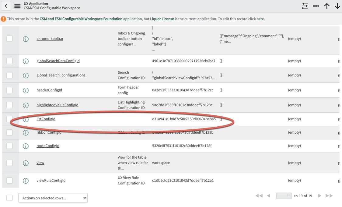

In the navigator go to sys_ux_list_menu_config.list
These are your list configurations.  Once you create a new one, copy the sys_id of the list configuration.
Navigate to experiences.
Select csm/fsm configurable workspace
scroll down to the UX page properties.   Look for ListConfigID. Drill in and replace the value with the list configuration sys_id you created above.
Hi Carol,
Thank you for your response.
I've configured the listConfigId according to your suggestion but list layout doesn't change.
