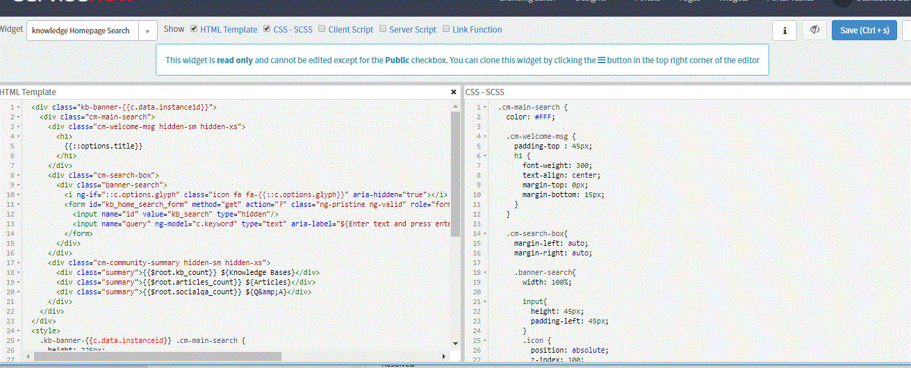

How can i change the text color on the knowledge portal main page. Please refer the attachment and guide me

It looks like the color for the search widget is defined in the widget itself. You will need to create an update set in the "Knowledge Management - Service Portal" application and select that application. then go to the below link and edit the CSS section accordingly.
/nav_to.do?uri=sp_widget.do?sys_id=04ec050ddb53220099f93691f0b8f538
There is a style there called .cm-main-search. under that you can set the color to what you want.

.cm-main-search {
color: #0000;
.cm-welcome-msg {
padding-top : 45px;
h1 {
font-weight: 300;
text-align: center;
margin-top: 0px;
margin-bottom: 15px;
clone the widget edit it.. i want the text color as black and made the above code
