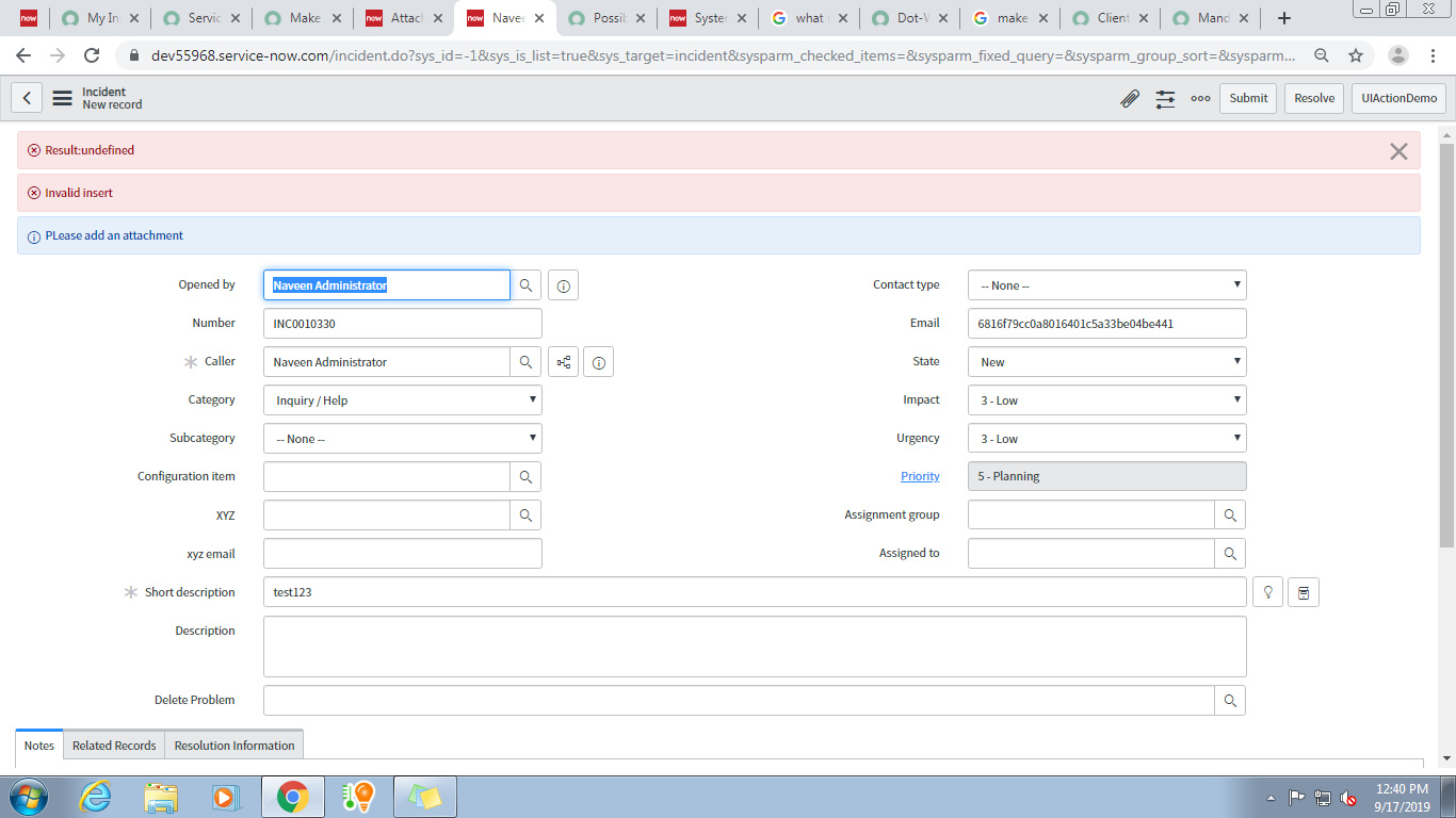

09-17-2019 12:12 AM
09-17-2019 12:13 AM
Even when attachemnt is added, It's showing same error msg.

09-17-2019 12:18 AM
I have tested the code and its working. Above code will for sure, If not Share you code so I can figure it out the error.
