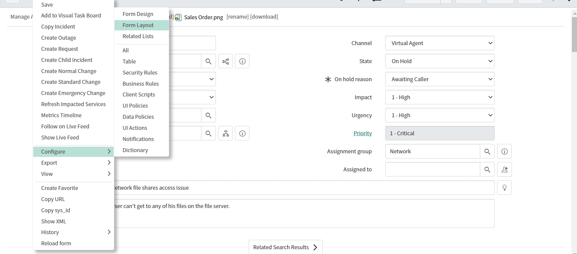

please refer below link and while creating you can not see activity stream because it will appears once record is created.
make sure glide.ui.activity_stream.form_button this system property is true in order to add in form layout.
you can check go to sys_properties.LIST in the application navigator and make value as true
1. Right click on the form and go to the configure > Form Layout.
2. Add the Activities in notes section as shown below.
Hope it helps!!
