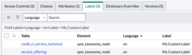

In order to to that, I went to the column dictionary and altered the Taxonomy node label to My custom label.
The parent column references a record of the same class.
This change worked for the taxonomy node column, but it did not work for the parent.taxonomy node column.

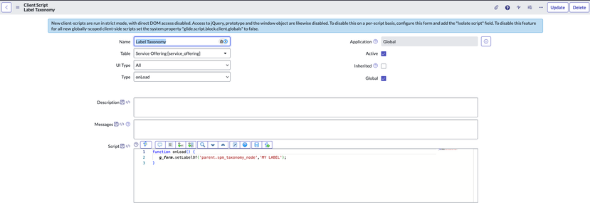

I tried to create a onLoad Client script and it also did not work.
It works if I change for all the CMDB hierarchy starting from cmdb_ci_service, but I need a solution only for the 2 mentioned classes.

sizzleMcFace
Most likely the "Parent" field is a reference to "cmdb_ci_service" table, not one of the mentioned child classes.
This also explains why it works if you change it for this table, but not for the child tables.

In the parent column, I changed the label for the tables I wanted.
I expected that the system to follow it.
