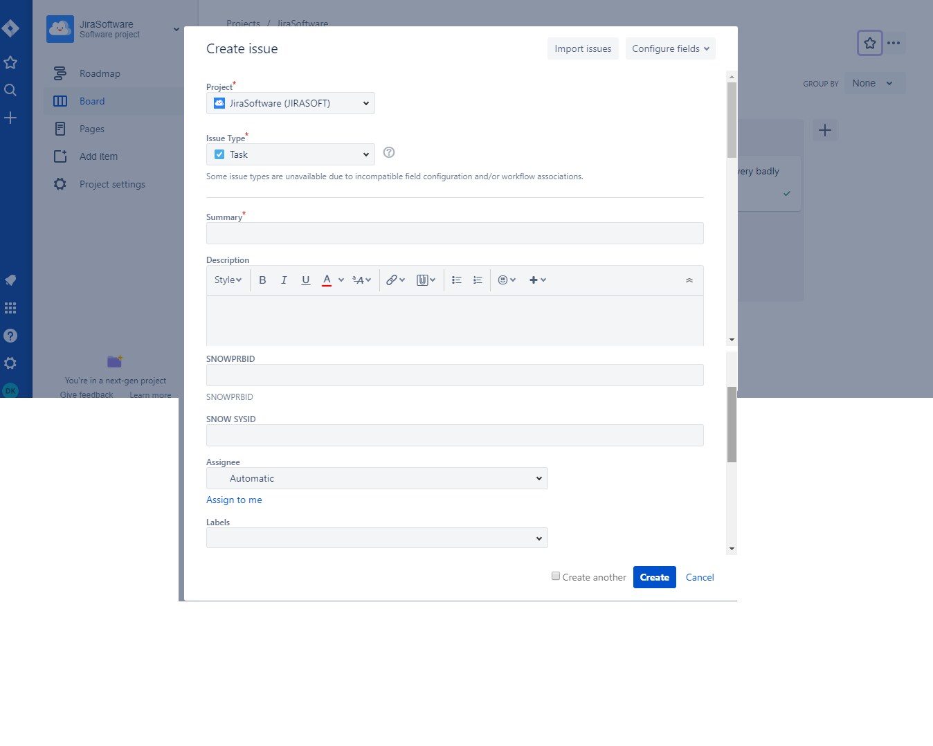

05-09-2020 09:43 AM
can you help me on POST method?
try {
var r = new sn_ws.RESTMessageV2('JIRA_POST_GET', 'POST');
r.setXMLParameter('jqlstring', 'project=JIRASOFT');
r.setStringParameter('issuetype', 'Task');
r.setStringParameter('description', current.description);
r.setStringParameter('summary', current.short_description);
r.setStringParameter('SNOW_PRBID', current.number);
r.setStringParameter('SNOW_SYSID', previous.sys_id);
current.u_sent_to_jira = true;
var response = r.execute();
var responseBody = response.getBody();
var httpStatus = response.getStatusCode();
var obj = JSON.parse(responseBody);
current.u_jira_issue_id = obj.id;
current.update("Updating Sent to Jira to true");
gs.info('BR:Post to Jira:Info:' + "Created new PRB:" + current.number + ",JIRA ID: :" + obj.id);
} catch (ex) {
var message = ex.getMessage();
gs.error("Br:Post to Jira: Info :" + message);
})(current, previous);
