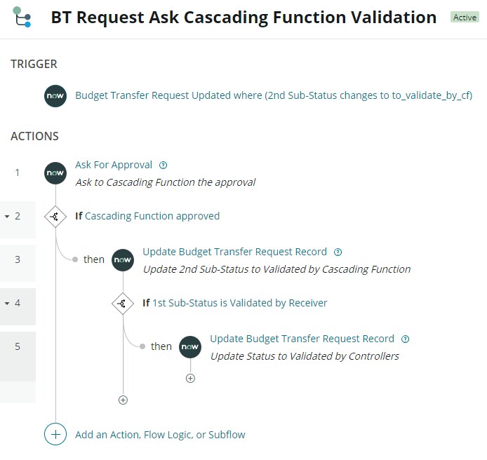

08-19-2022 07:32 AM
Hello Arav,
In my request, I have 2 columns: "1st sub-status" and "2nd sub-status"
When the user click on a button, we change the values of these 2 fields in the same update. I created 1 flow by sub-status change because, in a case, we can revoke the approval of 1 sub-status, and so re-execute the specific flow.
My flows:
Jean-Vincent

08-22-2022 12:07 AM
Thanks for your answer.
The solution is to use parallel action in the flow. With this way, the multi approval works correctly, maybe due to the context of the flow. If we use an Ask for Approval for the same record in the second flow, we have the issue...
I will change my flow to use parallel ask for approval.
