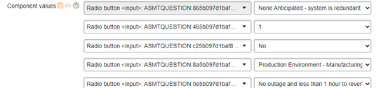

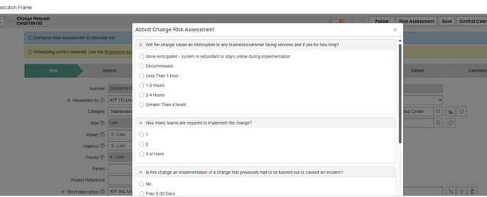

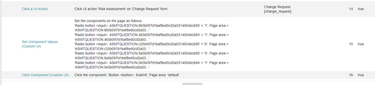

i'm trying to fill out the risk assessment from a normal change. Once i click risk assessment it opens the form and the i tried using a 'set components values' step to set the response for each question but i get an error that it was unable to set the component and component not found

You have to do this with a custom Server Side Test step.

Is this a limitation? I can get to the form see all the questions and answers, find the component values but it has a problem selecting them when the test in ran?
Yes this is a limitation on in AFT. The work around is to create your own Server side test step.
