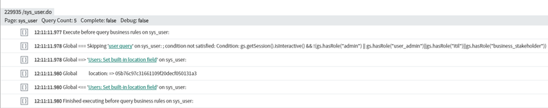

I'm currently trying to run a before business rule that will set the built-in "location" field in the "Users" (sys_user) Table based on a custom "location" (u_location) string field on the same table. The issue is that no matter what I try, the built-in "location" field isn't being set.
I can see in the session log that it looks like it's setting the sys_id of the cmn_location record to the reference field, but the field still appears blank.

Here is a copy of my before business rule:
	// Query the Locations (cmn_location) Table
	// Find a record that contains the value of the custom location field (u_location)
	var gr = new GlideRecord('cmn_location');
	gr.addQuery('u_name_and_address', "CONTAINS", current.u_location);
	gr.query();
	// Set the value of the built-in location field (location) to the sys_id of the Location Table record
	if (gr.next()) {
		current.location = gr.sys_id;
})(current, previous);

Hi, can you see the field content from a list view?
Have you checked xml of an updated record to confirm that the field is empty, and not just an issue with display?
Is there a QBR hiding the cmn_location data from user view?
If the field is empty, your BR is running and populating the correct sys_id, then perhaps there is another script running after your BR (that is emptying the field). If not a BR then potentially it is flow or workflow and you could check flow\workflow context to see if any of these are running during a record update.

Perhaps next step is to add some debugging\logging to the script that you are using to set the value, so that you can confirm that a value is being populated by the script and that the value is correct\expected for the table that the reference field maps too. Maybe something like
	gs.info('My debugging | u_location | ' + current.u_location);
	gr.query();
	if (gr.next()) {
		gs.info('My debugging | set location | ' + current.location);

@EvanAAmyotte Could you please try the following script and see if it works.
	gr.query();
	if (gr.next()) {
		current.location = gr.getValue('sys_id');
Also, please check if there is any reference qualifier set on the OOTB location field which is not letting the value set on the field.
