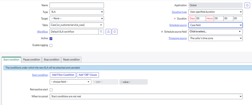

Hi James!
How would that work? Create a new field on the Case table, then configure the SLA Definition to use Schedule source as Case field, then Schedule source field would be the new field I create? What would the duration be?
So, once the Case is closed, it would input the duration time in that new field?
Hi @MStritt,
I would create a new SLA definition with the following conditions (note that these will need some adjustments that align with you requirement):
  • Start - Case is created
  • Pause - Substate = waiting on customer information
  • Stop - Case is closed
Once the SLA is defined, you can refer to its SLA task to find its duration by referring to its elapsed time (No additional scripting/calculation required).
Since this is merely used to measure the duration, you may want to remove all the workflow/flow associated with the SLA definition.
Cheers
