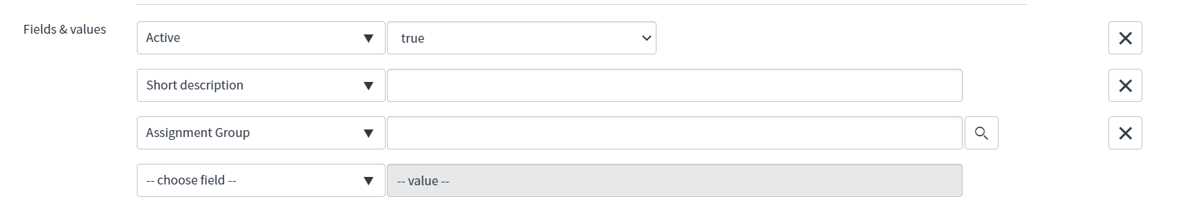

HI All,
For one of my requirements, I have to check while updating a form if the template value contains fields like
Short Description and assignment group  with values, currently I am using below script with split twice, but somwhere I feel like we have better way to configure this also this script is not validating in case one field is missing. Looking forward to the comments on this. Thanks

U_verma
HI Tushar,
Thanks for the code but this only works to check if it has short description and assignment group and not if it is blank,
However I was able to tweak the regex bit and now it is working as expected.
var templateValue = current.u_template_values;
if (/^short_description=[^|^]+?\^assignment_group=[^|^]+?\^/.test(templateValue)) {
 current.setAbortAction(true);
gs.addErrorMessage('Please include both "short_description" and "assignment_group" in the template with values.');
Thank you so much for your Help!!!
