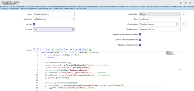

@alberttagle Please follow the below steps to populate the values to the string field.
1. OnChange client script for list collector
2. Create and call the script include in client script,
3. Finally the result of cascading the values to string field.
Note: Kindly ignore the "Alerts" which I have used for testing it.
Please mark this as helpful and accept it as a solution if this resolves your query.
Sujatha V.M.

04-05-2024 10:52 AM
Hi, Sujatha.
Thanks for this, I need to add some conditions and other variables in conjunction with the above. I tried to do the below but it's giving me an error.
Can you pls advise how do I add this to the script include?
04-05-2024 11:29 AM
Remove the lines 14 and 15 inside the function response and move it above line 4.
Sujatha V.M.
Sujatha V.M.
