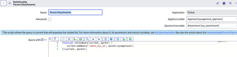

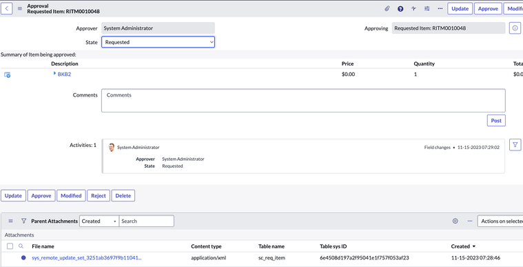

Copying attachments should be avoided wherever possible as this unnecessarily bloats the database, and is not kept up to date when the attachment(s) change.  A better approach is to create a related list and add it to your Approval record so that the current attachments of the record being approved are always displayed.  Create a relationship that looks like this
