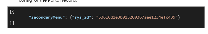

The secondarymenu would be the regular header menu I think. Have a look at "Service Portal > Menus". I don't know what your current Menu is, out-of-the-box probably "SP Header Menu". Copy that sys_id for the secondarymenu.
If you open your Header, have a look at the Menu Items on the bottom. Something like:
That should represent what is shown on your portal:
(not entirely, for example the Cart and the User name/photo are in the Header widget itself)
Kind regards,
Mark
LinkedIn
Community article list
Thank you, I duplicated the OOB SP Header menu and replaced the sys_id in the below screen shot with the new menu sys_id and it worked. 🙂
