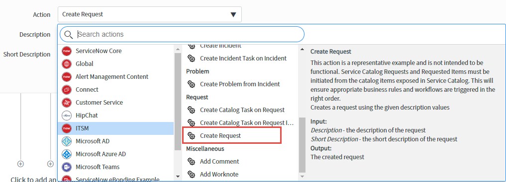

Hi all -- I'm looking to auto-create a request & requested item record after certain conditions are met which will also trigger the workflow associated with the requested item. However, I'm encountering issues when trying to set the variable values on the item and also triggering the workflow associated with the requested item. Has anyone successfully navigated this use case?
The out of box 'Create Request' action says that it is not intended to be functional.
