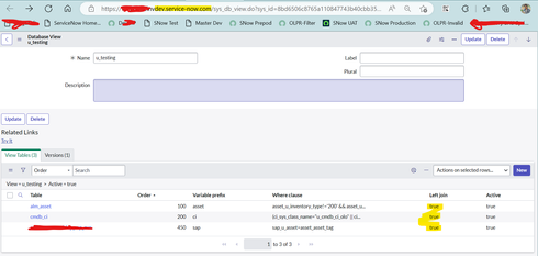

Dev instance:

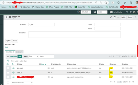

Test instance:
Here in 3rd table matching fields are String data type.
