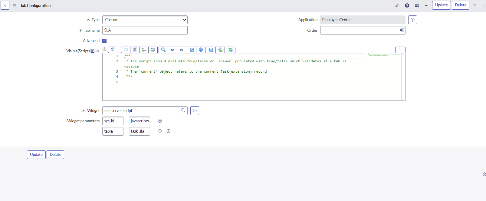

You are using options.table and option.sys_id in this widget it is always going to return table as incident and sys_id as incident record sys_id so try to give different name while passing the parameters like incident_sysId
You can also use the widget without passing the parameters as while query you can use 'task_sla' table and by using using options.sys_id you will get incident's sysid
And
Use grSLA.getValue('business_duration') instead of grSLA.businessDuration it retrieves the field properly
TAb Configuration:
