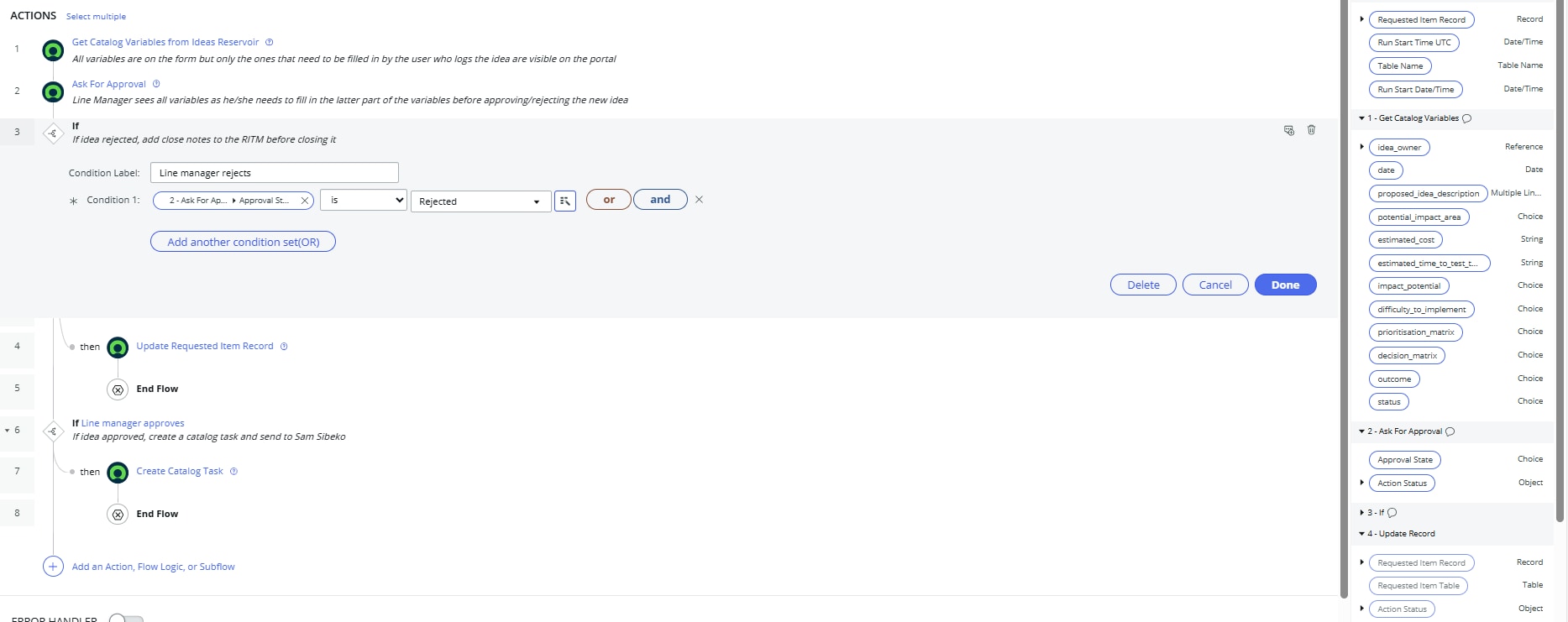

03-19-2025 08:30 AM
Thanks Vishal for the suggestion. So how should the flow look then? I attach screenshots of what it currently looks like. I am not sure how to get the line manager to pupulate the same record?
03-19-2025 09:09 AM
Hello @Thereza Van der
Without the license the flow is going to be a bit complex:
1. When you send an e-mail to the manager, then manager should get a link of a record producer which he/she clicks to fill in the variables values along with a variable as Approval: Approve / Reject etc.
2. Then you need to use this record producer to update the sysapproval_approver record as well as update your record where those variable values need to be populated.
3. Based upon the above, you can trigger a new flow or Business Rule to continue forward like creating a catalog task or something.
I believe all of this is achievable without a license.
