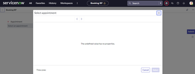

01-23-2024 02:23 AM - edited 01-23-2024 02:24 AM
Why empty booking window is coming.

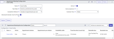

My record producer on case table has been linked to Appointment booking config for same table

01-23-2024 03:02 AM
Thanks. I figured and fixed the issue. The appointment window was getting blank because the user field mapping was missing for which the appointment was being set up. This has been updated from the appointment booking configuration.
