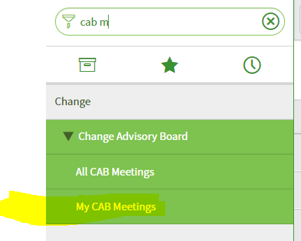

In newyork release you can send the calender invite from the cab meetings.
You can see the send meeting request UI action in related links. if you click on it meeting request will be sent to the users.
Now the meeting notifications will be sent out from here.
Thank you.
‎11-19-2019 07:38 AM
I am not able to see any CAB meeting option my application menu
