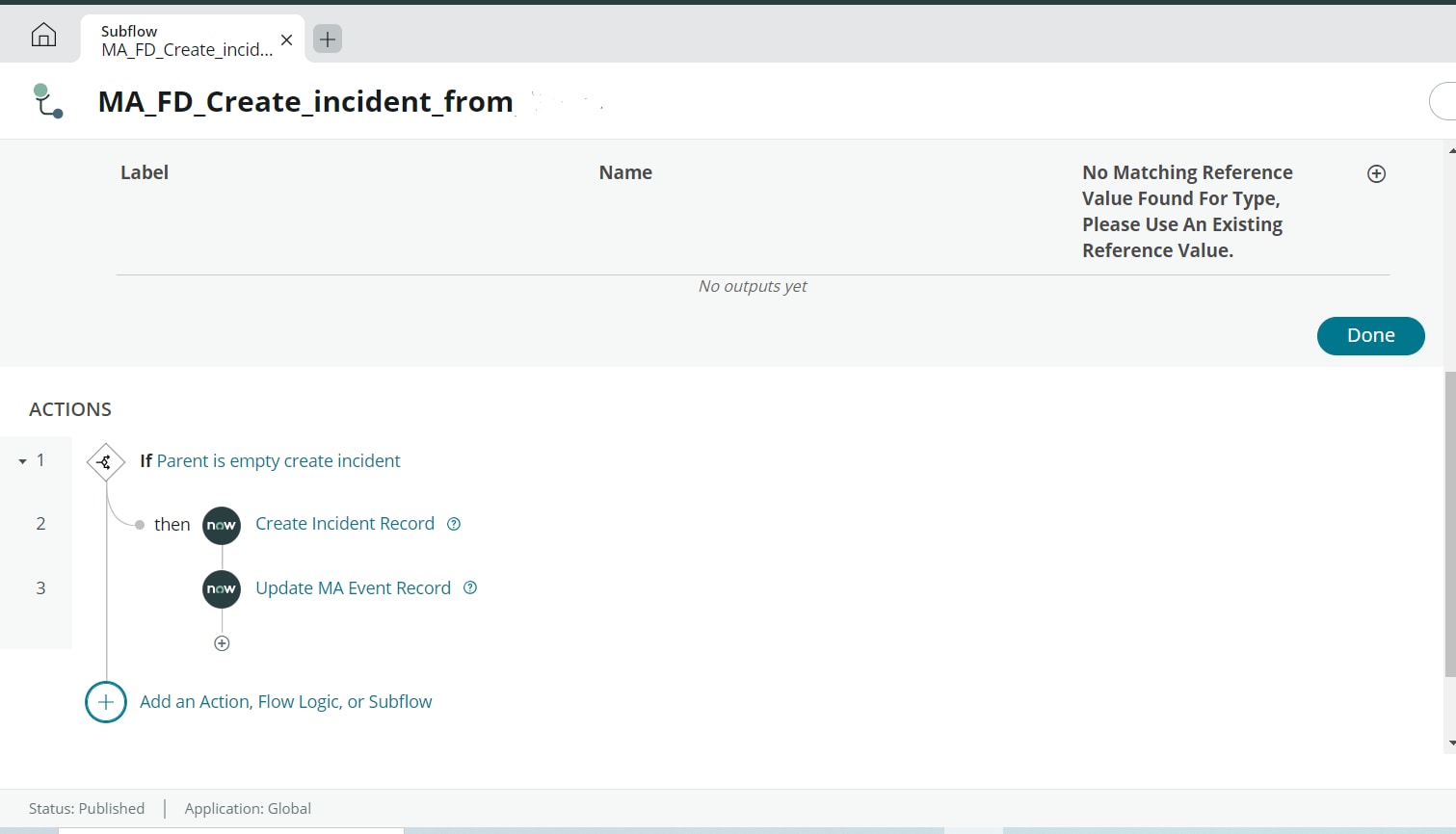

Hello experts,
I have designed one flow to create an incident when the parent field is empty on the XYZ form.
which is running fine.
now my requirement is when the system properties value is true our flow will create an incident if its system properties value is false our flow should not create incident.
I have created my custom system properties. i have attached my sub-flow screenshot below.
please guide me on how can i fetch system properties and check whether their value is true or false
thank you.

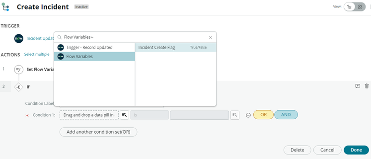

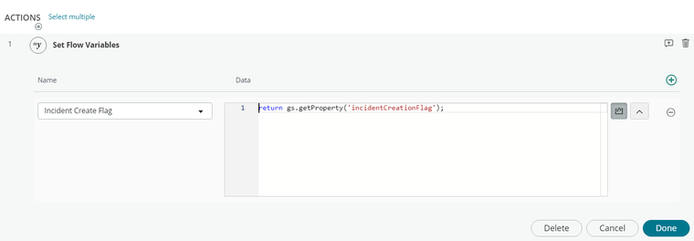

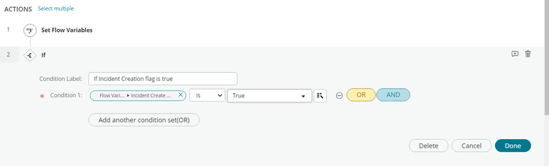

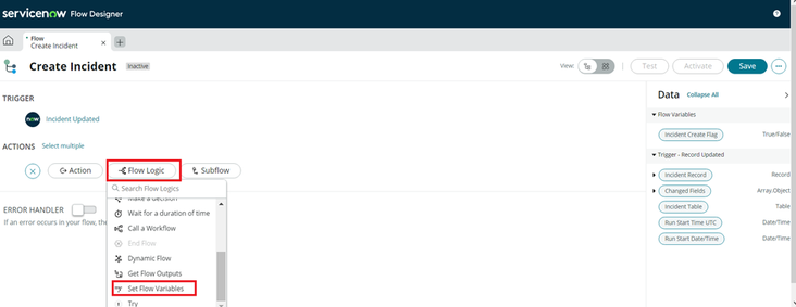

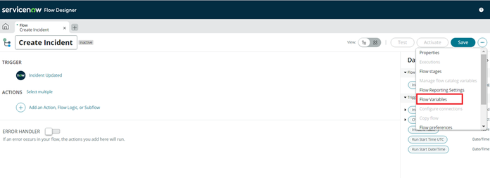

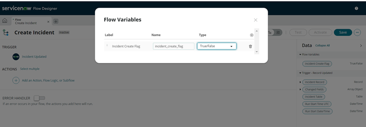

@abhijee You can achieve this by using flow variables. Create a flow variable of type "True/False". Write script to fetch the system property value and assign it to flow variable. Follow below steps
1) Create flow variable by clicking on three dots icon next to Save button in flow as below
2) Set the flow variable value using flow logic and write one line code to get system property value

‎08-11-2023 12:17 AM
