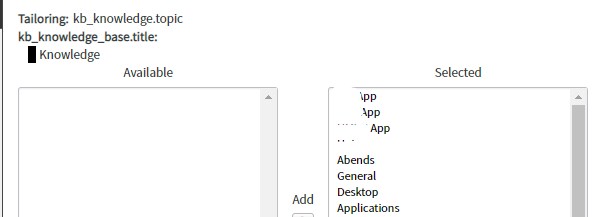

I have created separate knowledge bases and I want different topcis and categories for each knowledge base. I've created a few new topics but I don't see where I can make those topics specific to one knowledge base.
Any ideas?
I've tried configuring the form, I've trying configure ALL so I can see if there were UI Policies or anything else on where I make these changes. I didn't find anything.

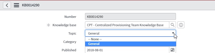

Can you post a screenshot of your knowledge form? Topics aren't really used in the newer releases of ServiceNow (in favor of a hierarchical category structure) so it would be helpful to see specifically what you're working with. I'd also recommend moving to the new category structure if possible.

Hey Mark - I am beginning to create separate knowledge bases for each area:
When the customer that has access to that Knowledge Base goes to a published article or creates new, I want them to see the topics that I created for their knowledge base so that I can apply UI Policies for those topics. That UI Policy would say show these categories when Topic = Abends or whatever.
