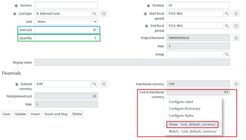

I have a demand with several Cost plans.
I have a cost plan with 10 unit cost, quantity is 1, as far as I know "Total planned cost" is calculated (unit cost *quantity).
I don't get how Cost in functional currency is calculated and I have checked over the platform Business rules/Script includes which most of them seem to be on cost plan breakdown(cost_plan_breakdown) table.
I thought that maybe the field is populated with total planned cost * value from itfm_fx_rate table but it seems I was wrong.
I have noticed that if I change End fiscal period, the value from cost in functional currency changes.
Can someone explain how is cost in functional currency(cost_default_currency) calculated?

Thanks for answering. I see that the value from "Unit cost" from Cost plan is updating the "Entered cost" and "Functional cost" from the particular Cost plan breakdown.
Somehow I think that the "Cost in functional currency" from cost plan is calculated based on "Entered cost" or "Functional cost" from Cost plan breakdown value.

Hello
Thanks for the information, but what I don't get is where is the "Cost in functional currency" field calculated/converted? The link isn't working.
Also, is it related somehow to cost plan breakdown?
